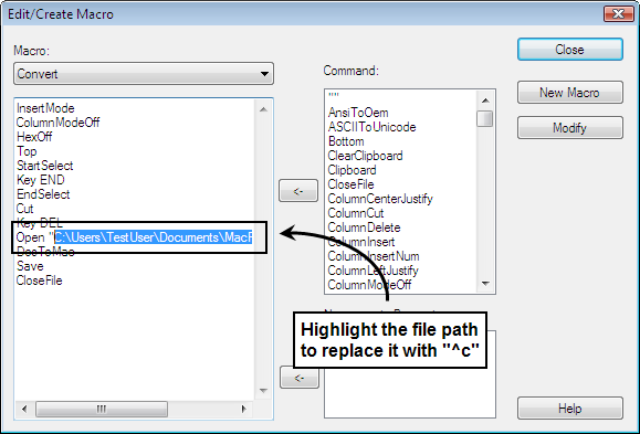

Postby Bego » Wed Jun 06, 2007 6:37 pm
Must have been blind or I forget things too fast.
I once created a solution for backups (should work for FTP too).
backup
Just replace the filepath stuff with a hardcoded c:\backups\" or sth. like that and forget about the replaces.
With a bit of work it should be easy to get this running.
rds Bego
