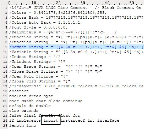

trying to get indenting working with
1.
if x then y
rather than
2.
if x then
y
endif
I've tried telling ue to only indent on "then$" but it seems to do it no matter where the string is found. any way around this?

Now I understand. But there is no solution for that problem. UE doesn't know if the text following indent string "Then" is the code which belongs to the If condition and so the next line should not be indented.
If it would be possible to specify that an indent string must be on the end of a line, then this would not be a problem. But this is not possible. Write a feature request email to IDM support. But such a limitation would mean you must take care never to have trailing spaces/tabs or a line comment after "Then" when the code is on the next line or UE would be flexible enough to handle this also when the limitation with end of line is active.

What I did was: I removed "Then" from the /Indent line and added "If" instead, and then I remove "End" from /Unindent, adding "End Function", "End If", "End Sub", "End Select", and "End With", thus ending up with:
/Indent Strings = "If" "Select Case" "Do While" "Do Until" "Else" "ElseIF" "Do" "<td>" "<tr>"
/Unindent Strings = "Next" "End Function" "End If" "End Select" "End Sub" "End With" "Loop" "Loop While" "Else" "ElseIF" "</TD>" "</tr>"
