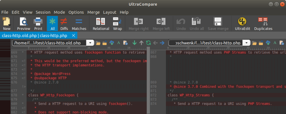

In UltraCompare activate View - Show Line Numbers.
In UltraEdit you can also activate View - Display Line Numbers. In UltraEdit you must have NOT checked the configuration option Disable line numbers at Configuration - Editor Display - Miscellaneous.
As long as the configuration setting is not enabled you can see always in UltraEdit the current line and column number in the status bar at bottom of the UltraEdit window: Ln x, Col y, Cz = line, column, clipboard.
UltraCompare will not show you the line or column number in the status bar because it uses it for compare infos. It is mainly a compare tool and not an editor.

Swiss, maybe good news for you: UltraCompare v5.00 shows now also the line and column number of the cursor in the active frame in the status bar like UltraEdit.
